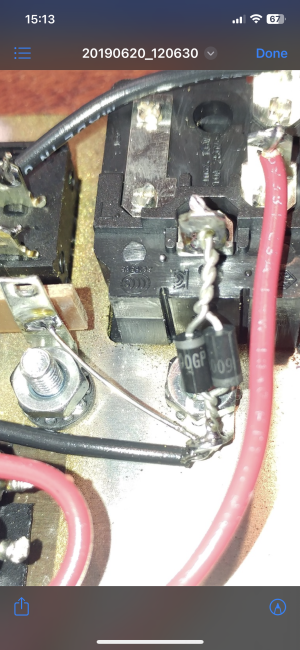

Reply #4 on: August 11, 2023, 05:16:26 AM
Is this a possible sollution for my Mainline issues ?
See attached photo
Reply #5 on: August 11, 2023, 05:22:31 AM
Yes, that's what's in the link that I posted.

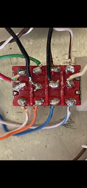

Reply #10 on: August 13, 2023, 05:25:17 AM
Hi !
Here is a photo of the input switch. It seams to me that the connections are ok apart from the fact that I have spilled some solder on one of the pins. The solder reaches one of the metal side plates of the switch. Does this mean that this pin has continuity to ground and should I remove this solder ?
Reply #11 on: August 13, 2023, 05:27:18 AM
If that solder touches the metal, you will lose the audio from that channel.

Reply #13 on: August 14, 2023, 02:40:08 AM
Checked this soldering issue under a magnifying glass.
It is nowhere near the side plate. The angle of the photo doesn’t show it.
Please respond to my earlier question.
With regards,
Bergur
Reply #14 on: August 15, 2023, 06:16:36 AM
A little bit of signal bleed isn't necessarily abnormal and isn't a useful piece of information for debugging.  If you put a pair of shorting plugs into the unused pair of RCA jacks or if you hook up a second source that's powered on, the signal bleed will reduce substantially (likely to inaudible levels).
