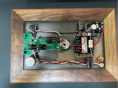

Can you flip it over and show us what's underneath?
Offline Varail
    • Posts: 13
Here it is ..  The sound is really nice so I don't think the device is defective but the fact that I can maximize the volume and still having room for wanting a bit more it is a bit suspicious ( Im a newbie regarding electronics but I just to make sure there is nothing amiss ).

Your Crack appears to have the L-pad mod (the four resistors installed on the gain control lugs), which reduces the gain, usually by 12dB.

99.99% of folks who use the Crack complain about how sensitive the volume control is, so I build that pad in by default when building a factory built Crack (which that is).
Your DAC looks to put out 2V or so of signal voltage, and you should still have about 12dB of gain available, which would give you 8.7V RMS (or 125mW) into your headphones.  This is a TON of output and would be ear splittingly loud.
I would very, very strongly suggest that there's some volume control on your PC that isn't turned up all the way (or on the DAC itself perhaps) and rather than modifying the amp, I would chase down where that bottleneck is first.

Removing the pad will make it play louder. I your photo you can see a small tan resistor connected between the two outer terminals on the volume potentiometer (one end is where the white wire for the left channel is connected through a big tan resistor and the other end where the black wire for ground is connected). This resistor gets removed. There will be another small tan resistor just below it connected the same way to the potentiometer terminals closer to the chassis (right channel, red). Remove it too.
The next step is slightly more involved. There is a bigger tan resistor that connects the white wire the terminal on the potentiometer. That resistor needs to be snipped out. Then solder the loose white wire directly to the terminal where the big tan resistor was soldered. You now have the white wire connected directly to the pot terminal without the tan resistor in between them.
Once again there will be a similar larger tan resistor underneath that is connected to the red wire and to the lower terminal. Do that same thing here, remove the resistor and connect the red wire directly to the pot terminal.
All of this returns the input wiring to the stock kit configuration.
I would also advise that if you are hiring someone to do this rather than taking it on yourself, a competent technician should understand what an input pad is and know exactly what I am describing here. If he does not, find a tech with more knowledge.
