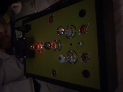

Cleaned both the pins. Same result. You can't even see it lit up in this picture. One lights up at the very bottom, the other not at all. Both get warm.

See how the top of the left EF86 is white instead of silver? Left EF86 is cracked and the getter is shot. Replace it.

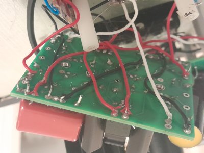

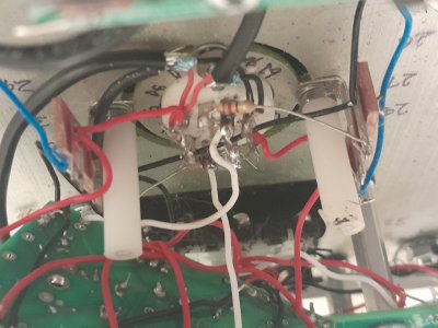

Unscrewed thldere board. The white wire attached to C8 had been knocked out. I resoldered it. Powered it on. The LEDs on the A side of the board turned on, so I started to do voltage checks only to notice the LEDs had cut back off. Here are pictures.

Any advice? Thinking of completely replacing the wire pictured. Do I just need to send it in to fix my mistakes? Just want to know what my forward path is with this project.
