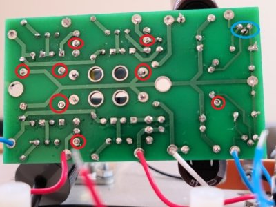

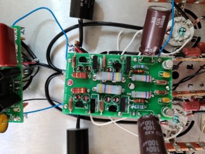

Doing my voltage checks I'm running into some problems  on the right side of the C4S board, OD measures 140V, OKA 138V, OKC is not reading voltage. The left side is w/in tolerances.
    • Posts: 20302
Reply #10 on: November 05, 2023, 03:54:50 AM
What does your meter actually say at OKC?  0V is a valid measurement.  A lot of Eros repairs I get with similar problems just have missed solder joints on that center board.

    • Posts: 20302
Reply #13 on: November 05, 2023, 10:40:39 AM
I would look for solder bridges or debris shorting pins on the bottom side of the PC board.

Reply #14 on: November 06, 2023, 04:46:11 AM
I have gone over the board, soldered any questionable connections, checked for bridges but the right side is still not right:
IA 217V In range
OA 206V A bit high
OC 57V Low
OkA 62 Low
OkC .07V(?)
