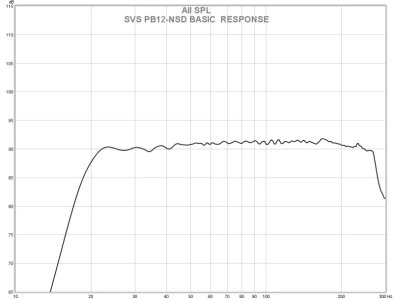

Thanks for the feedback Steve! My Klipsch RF-7ii are rated 30Hz-24KHz ± 3dB. They do a really good job with all but the lowest bass frequency.
I have a pair of SVS PB-12NSD that are superb with music that extend linearly into deep territory. They were unreal with home theater too.
I did integrate them with the Klipsch speakers using Moreplay and a power amp but found that I was enjoying the speakers without the subs just as much. And hence what set me on the path to the Stereomour.
