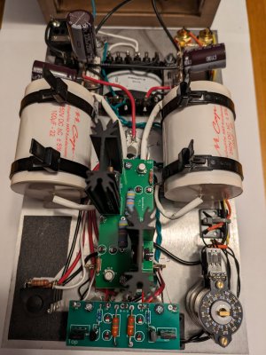

As mentionned in a previous post, I have completed a Crack with speedball option, step attenuator DACT CT-2 (100K) , Mundorf film capacitors on audio path and choke 157M ( 8H, DCR=259 ohms) .
I did a verification on each step with success. However I have some issues:
1) The DACT has 23 steps. If the audio signal is off and I turn up the volume I can hear some crackling on each step after step 16. Is it normal?
2) With the audio signal OFF, I notice if I put the volume at max and reduce to mid level or 3/4 level, I can hear a kind of strange low level noise. The noise looks like an old dial-up modem in the 90s. The noise stops after a while. Any body can explain that?
I am using a Beyerdynamic DT880 Pro. In fact I built this amp for one of my friend.
My friend is using a ZMF vérité with different home and the noise is a bit louder.
I also have notice today that my 120 Vac outlet at home shows open ground with Klein Tool tester.

I have installed the Ground Breaker as you have suggested, however I still have issues with hum on the ZMF vérité.
Is it possible that the headphone ZMF Vérité is too sensitive for the Crack. Impedance is 300 ohms which is OK but sensitivity is 97 dB/mW which seems a lot for me but I don't know the standard for headphone sensitivity.
When the Beyerdynamic DT880 is used, I do not hear any hum or hiss or crackling. My friend is listening with the ZMF at very low volume (about quarter of the step attenuator). We can hear a slight noise only on the left channel.
I have also noticed that the input tube is microphonic when I slighty tap on it with the ZMF connected but the tube is not microphonic with the Beyerdynamic connected. Furthermore when the step attenuator is turned up, there is a kind of microphonic noise on each step which do not happen when the Beyerdynamic is used.
Bottom line the Beyerdynamic is doing very well with the Crack. Hovewer the ZMF has an amazing soundstage.
P.S. If we unplug the audio cable from the Crack and turn up the step attenuator, there is no hum in the ZMF.
Any recommendations?
Thank you in advance

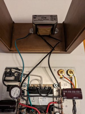

I didn't cut the leads on my choke. The choke is screw on the side of the wood base. I have put a ground wire from the choke base to the terminal 16U. Do you think the choke can interfere with the audio signal?
    • Posts: 20204
Reply #12 on: November 27, 2023, 02:20:27 PM
Did you build the amp stock first and try it with the parts we provided?  Generally you'd want to start here, then add whatever mods you have planned one at a time to be sure they don't introduce problems.
