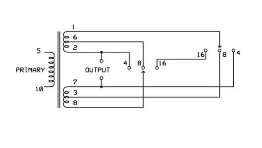

Hello again, I would like to install an ohm switch for the paramount. I have the manual and will see in there what will help me. But any wiring diagram would help. What perticular switch and wire should I use? Thank you.

    • Posts: 20286
Reply #6 on: November 25, 2023, 06:08:11 AM
Here is PJ's schematic for switching the OT-1.  I believe he intended it to use a 4P3T rotary switch per chassis, which is a standard part that we have tons of, but a 2P3T switch would also work.

Is that schematic the final info? I definitely want to understand the wiring 200% before I go and mess with the opt.

Reply #8 on: November 25, 2023, 07:18:14 AM
Also I doubt I'm going to utilize the 16 ohm tap so double throw double pole?

Reply #9 on: November 25, 2023, 07:24:09 AM
Yes, that's the diagram I was going to look for - thanks for finding it!
It was my intent to use the 4-pole switch, wired as two 2-pole switches in parallel to make a 2-pole switch with lower resistance and better reliability. The switch on hand was used as a preamp input selector at much lower current than the power output produces.

Reply #10 on: November 25, 2023, 07:26:32 AM
That should work well. Most DPDT are rated for 15 amps so there is plenty of current-handling capability.
