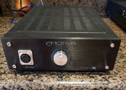

I modded an old Emotiva A-100 50W speaker amp a awhile back to drive my HE6se. I used a 15/16 stepped drill bit to punch a hole into the faceplate and then used a 4 pin XLR jack wired directly to the speaker taps internally using twisted wire. Works beautifully, dead silence, and gobs of scary power. I wouldn't try doing that with a stereomour without knowing more information if it's wise to do it or not. In my case, I have Crack and SEX amps for headphones use and have plans to use Stereomour dedicated to speakers.
