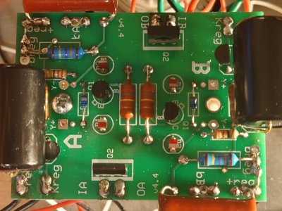

Are +reg and Breg jumpered on the center board as shown in the manual on page 58 at the very bottom?

Yes bridges look correctly done. Photo of my board attached for ease.
Thank you for the quick reply!
David

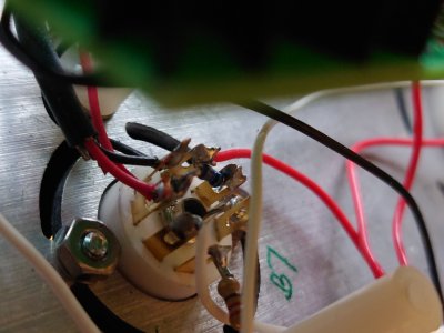

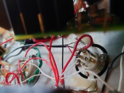

Could you post a picture of the wiring around each 7 pin socket?

How's this?

It should not matter, but it might be worth double checking that you also see 0V at pin 7 on each 7 pin socket.

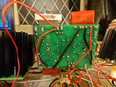

I'd also be interested in the DC voltage present at the terminals marked X on the center C4S board, as well as a bottom shot of that center C4S board.
I've also sometimes encountered oddball problems like this when the power supply feed going into IA is accidentally wired into OA, or the wire that's supposed to leave OA and feed the rest of the amp is instead fed from IA, though these issues are not necessarily indicated by the voltages you are reporting.

Board underneath...

I would double check that the 431 regulators are in the correct spot, then resolder their connections if they are where they should be.  The 3V at X tells me that the 431 regulators aren't doing anything.   Also be extra certain that all those black jumpers on that center PC board are well soldered.
