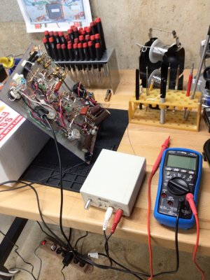

Ok, I am using a 1 kHz oscillator to input a signal to the Moreplay.  The left channel output of the oscilator is 2.82 VAC and the right channel is 2.90 VAC.  I have the ground lead of my DMM attached to the ground lug closest to the channel selector.  With the volume pot set to twelve o'clock I get a reading of 0.210 VAC where the red wire is attached and 0.185 VAC where the white wire is attached.
I get no meaningful voltage readings from the middle lugs of the balance pot or the output pins (the two that are not black) of the selector switch.  I checked the solder joints at the bypass caps and the 33K resistors on the balance pot, and they appear to be good to me.
I'm not sure what this means....perhaps I misinterpreted Paul's instructions.  When the preamp is in a system it sounds great, but I need to turn the balance pot 25% of the way to favor the right channel in order to get it balanced.
Any further guidance would be appreciated.  See picture of test rig below.
John
Reply #4 on: February 13, 2024, 05:46:42 AM
You'll need to set that meter to the mV setting and toggle it to AC (usually denoted with a ~).
You can do the selector switch and balance pot tests with the preamp off, so take some time to get those sorted before moving on to the others.
For audio ground, I would use terminal 2.  The chassis and the audio ground are not at the same potential in the Moreplay.

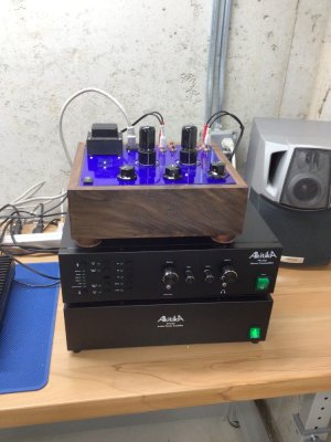

I'm currently using the Moreplay to drive a diyaudio First Watt F4 clone power buffer.  The F4 has tons of current, but it needs to get its voltage swing from the Moreplay.  The F4 has little sonic signature of its own so what you hear is the beautiful sound of The Moreplay.  I've got an Oppo BD-95 spinning discs into a Denafrip Aries II DAC.  The DAC and a VIP Classic Turntable feeding a tubes4hifi PH-16 phono stage are plugged into the Moreplay.  Speakers are the Arendal 1723 Towers.  It sounds amazing.

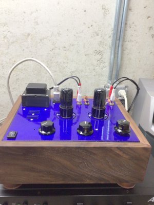

I don't think I ever posted pictures of my finished Moreplay on the Forum.  See below.  A friend in Montana built me a solid walnut base with round wooden feet that have cork bottoms.  I had the chassis plate powder coated in a blue sparkle metallic.  I think it looks cool.
Paul, thanks for the help in troubleshooting this.
John

Reply #14 on: February 16, 2024, 09:36:39 AM
Love the walnut, and the blue. I think it looks cool too.
