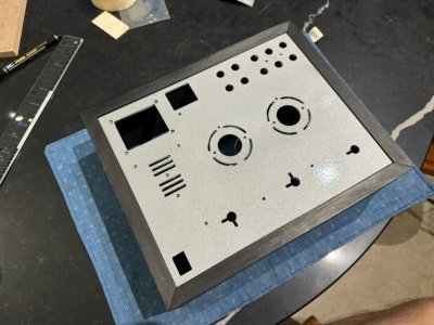

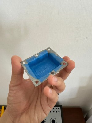

I stained the wood base using Super Black India Ink. Have yet to top coat using spray on lacquer.

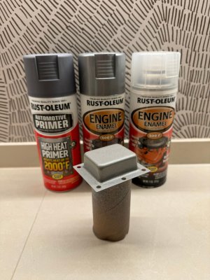

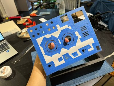

For the bell and chassis, after masking the back side, I spray painted with high heat primer first, then aluminium colored engine enamel and finally clear engine enamel. I chose these products because I wasn’t sure how much heat the tubes and transformer would generate and if normal spray paint would’ve worked or not.
I’m pretty happy with the color combination!
    • Posts: 9787
Reply #1 on: March 25, 2024, 06:00:20 PM
Regular spray paint usually works fine, but using the high heat paint certainly doesn't hurt. And it looks very nice! A tip for your wood base - a coat of shellac on the wood before you apply lacquer helps fill the grain,
 with fewer coats of lacquer needed. I learned that trick from an old timer when I was restoring antique radios. Just go easy when you sand the dry shellac before putting on the lacquer. If you get too heavy handed the shellac can get soft and gummy on your sandpaper.

Yeah, you have to lightly sand brushed on shellac to get it smooth before spraying lacquer. You can also use spray shellac. It will take several coats to build up enough to fill the grain. And yes, skipping the shellac and just applying a whole lot of coats of lacquer will work too. There are many different ways to do a lacquer finish. I've even used clear epoxy scraped smooth with a razor blade while still soft to fill the grain in mahogany before applying a finish coat.

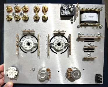

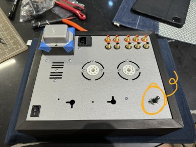

I've mounted all the components onto the chassis plate but am not sure if I've put the 4-pole 3-position rotary switch in the right place. The instruction manual says to mount it in the hole in the front left corner but in the accompanying photo it looks like it's mounted in the hole towards the side with the RCA jacks, which is the hole in the front right corner. I decided to follow the photo and so I placed it in the front right corner hole (refer to second photo). Is this correct?
I have annotated the underside of the chassis plate as the manual suggested and love how much it should reduce the chances of erroneously connecting stuff :)
Once someone's confirmed I've mounted the 4-pole 3-position rotary switch in the right place I'll move on to the hard part, soldering!

Reply #10 on: March 28, 2024, 06:09:12 AM
You are all set, good luck. Take your time and enjoy.

Reply #11 on: March 28, 2024, 06:43:38 AM
Your selector is correctly mounted.

Reply #13 on: March 28, 2024, 09:05:29 AM
I dont think is a typo. left or right will variate regarding if the plate is up side down or vise versa. For intalation the plate should be upside down thus the selector is on the front left.
Its great the instructions are so well ilustrated that clarify any question.

Reply #14 on: March 28, 2024, 02:12:17 PM
Thank you everyone for the confirmation!
Yes true that it is in the front left corner when viewing the underside of the plate. Perhaps a good way to phrase it would be something like “the slotted hole furthest away from the power switch”? Because then it’s viewing angle agnostic  :)
