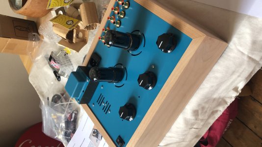

thank you for your kind offer! I really appreciate it! I thought I can avoid posting a photograph of my soldering, because I am not experienced at all, but here we go... :-)

The H terminals and the 3 ohm resistors make the tubes glow.  There's something not connected or not properly positioned there.  The shielded twisted pair wiring should not be up against the terminal strips, but rather it should come off the back and as much of the wiring should be pushed against the chassis as possible.
You also have a black wire that's just floating in the air not connected to anything.

you were absolutly right with the H-terminals! the red wire on H3 was just cut off for some reasons? I replaced it because when I dismanteled it I cut to deep with the cutterknife. The black wire is connected, it just looks disconnected. And the twisted wire doesn´t touch the terminal, its just a bit long I guess and not very good laid. But both tubes are glowing and the music plays just as beautiful as before!  I still have the grounding problem, that I mentioned in my first post. But for now I am very happy and grateful for your and Dr. B´s help!!!
