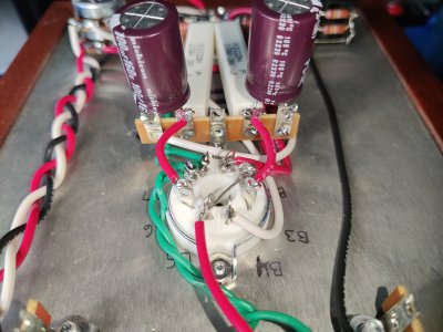

I have attached pics of the main solder joints. (They aren't the prettiest, but my work never is.)

The upper green wires at B7 and B8 don't look to be well soldered.
5L doesn't look well soldered.
6L doesn't look well soldered.
B1 needs more heat/more solder.
Poking around with the chopstick is the correct method to isolate this issue, but you need to poke at everything in the circuit, not just the components for the offending channel.
780F is not too hot for soldering, and it could be too cold depending on how long you're holding the iron against the joints.  (For reference, I solder at 900 degrees F)

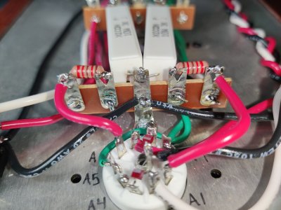

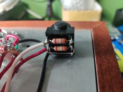

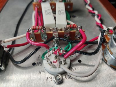

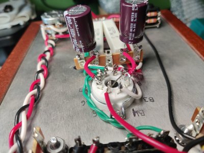

Since I thought I perceived an improvement, I re-soldered them one more time, and then went ahead and re-soldered most of the other connections on the amp to be a little more sure. (I have attached updated pics - please let me know if you would like to see any other angles or pieces of the circuit.) Again, it seemed much better at first, and was quite quiet for a few minutes, but it did eventually return, so I rechecked everything with the chopstick, on both sides of the circuit, but there was no discernable change to the noise at any component, wire, or solder point.
