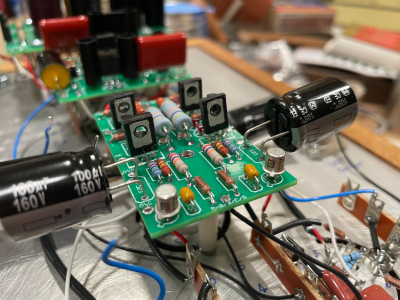

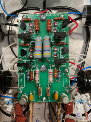

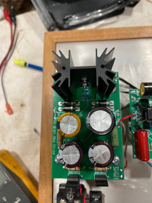

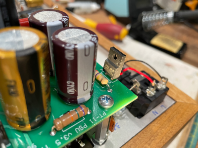

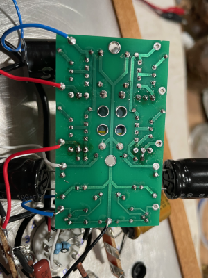

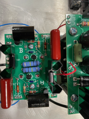

Paul, Thanks for all the help but I can't seam to get a picture for you, need to fine one of my grandchildren to help me. I get one in the attachments and then it says when I post file to big. How to make the picture smaller???
Offline David E
    • Posts: 23
Reply #5 on: July 04, 2024, 02:03:26 AM
Not very sharp, I'll try again hope this is better.
Offline David E
    • Posts: 23
Reply #6 on: July 07, 2024, 02:00:19 PM
Who said, you can't teach old dog new tricks. Hope this makes things more clear. Thanks for all your help. DLE
    • Posts: 20238
Reply #7 on: July 07, 2024, 03:28:05 PM
I would reheat the MJE350 transistors on the front C4S board, with a special focus toward the middle leg of each one.
Offline David E
    • Posts: 23
Reply #8 on: July 08, 2024, 04:48:31 AM
Thanks for the reply, I reheated all 4 transitstors on the C4S board, I think I burned them up when I turned them around the first time. there are my volt reading now:
