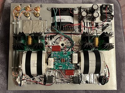

I then flipped over the top plate to take a look at the circuit and solder joints. Nothing jumped out as a bad/cold joint. When I completed the build two years ago, the joints were shiny and all resistance and voltage checks were good.

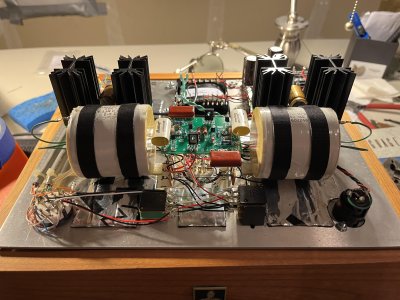

So, as Doc suggested, I turned the amp on while the top plate was inverted. And after downing a Monster for extra alertness, I carefully started probing the amp with a plastic chopstick, gently tapping on solder joints. First the RCA jacks, then the input selector, the balance pot, volume pot, tube sockets, terminal strips, output caps -- and there! The channel comes and goes when I tap one of the right output cap solder joints. The joint looked a bit dull upon close inspection. I turned off and unplugged the amp then reflowed the joint, added a little more solder, and kept the heat on the joint for a few more seconds before pulling the iron tip away. Nice and shiny!

Alright PB, I’ll examine tonight. However, I’m starting to think perhaps it’s my detachable output cap mod… Remember I used detachable spade connector things to be able to switch output caps easily? Which of course I’ve never done because I love the sound as is! But when I did the chopstick test, perhaps it wasn’t the joint but the connector next to it causing the intermittent output. I’ll take a close look at that as well and perhaps will remove it.
