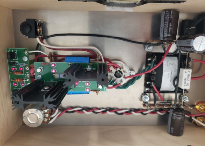

Hi all, I purchased a pre built bottlehead crack 1.1 with speedball and it didnt come with a manual. So I would like to know if it can be converted from 110v to 220v or is it better to use a step down transformer? I have attached a picture so that we are 100% confirmed that it's a 1.1 version.Thank you
    • Posts: 20168
Yes, that's a Crack 1.1.  Yes, you can covert it to run on 220, 230, or 240V.  Yours is wired for 120V for what it's worth, not 110V.

That kit does look to be very, very nicely made.
