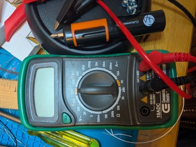

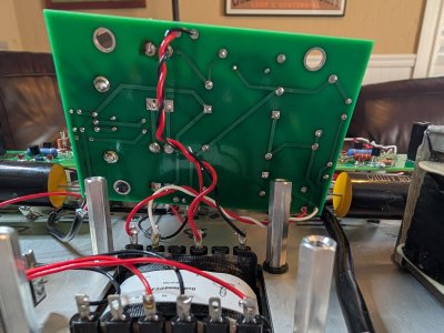

Reply #7 on: December 13, 2024, 05:56:17 AM
Can you unbolt the power supply board and show the bottom?  Can you let me know what meter you're using?

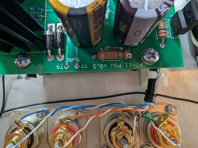

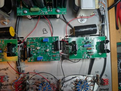

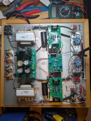

Reply #9 on: December 13, 2024, 06:42:33 AM
No signs of scorching on the diode and the band appears to be the right direction.  Photos attached plus a picture of the multimeter in question.
Reply #10 on: December 13, 2024, 09:24:29 AM
If you pot the board back and get your meter negative clamp back on the - terminal of the 275V pads, what DC voltages to you measure on each side of the little zener diode back there?
