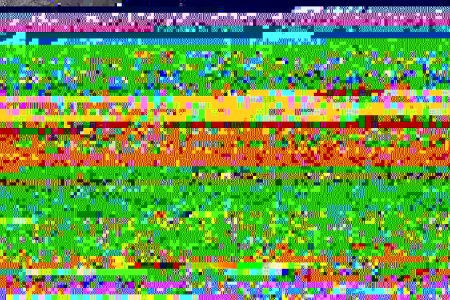

Well I rewet all joints at the socket and around it.  BUT, I don't think I properly diagnosed the problem before.  Although the first time it was the left channel that would cut out, now it seems that either the left or right will cut out.  If I touch the metal plate both channels play just fine.  Grounding issue?
BTW, here is a picture of it.

Reply #11 on: December 12, 2012, 07:38:05 AM
Check the connections from the 12AT7 to the volume control, and from the volume control to the selector switch. Sounds like it might be a missed or cold solder joint.
By the way, looks really nice!
