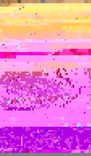

My tube damper test subject showed up today. Seems to help.

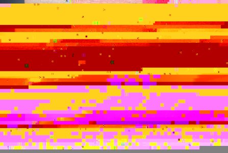

And here is a close up of the amount of compression of one of the 30D 1-1/4" Sorbothane hemispheres on the base. These really do work well to cut down vibration from the shelf.

Reply #3 on: February 20, 2013, 01:56:18 AM
Dan, your tube damper looks like the ring off of a giant condom.  What is it?

Reply #4 on: February 20, 2013, 03:51:09 AM
That condom looks sort of small to me.  :-)

Reply #5 on: February 20, 2013, 04:52:26 AM
I need to do a little more research before I share the details.
Reply #6 on: February 20, 2013, 05:57:28 AM
David,
I guess it depends on which tube it is on.  On my 76 drivers it is small, on the 300B a good bit larger.  But I've never seen the roll/ring that thick.

Reply #7 on: February 20, 2013, 11:34:32 AM
I use round welded stainless and bronze rings all the time at work.  Maybe plasti-dipped they could work as dampers?  Or maybe as is?  Hmm.. i should try this out.

Reply #8 on: February 21, 2013, 12:16:36 AM
I thought it looked like one of those rings you see at the carnival. Where you have to toss it over a bottle neck to win a stuffed animal.
Could start a new fad Doc. The bottlehead ring toss.
Reply #9 on: February 21, 2013, 04:59:14 AM
Ah shoot, I've been figured out! The other part of the package is an equipment rack made of giant stuffed animals.

Reply #10 on: February 22, 2013, 06:25:03 PM
Those kind of Sorbothane work good for me too, but a word of caution, they tend to be sticky, and most surfaces will show marks where they have sat. If sitting on top of a painted surface, it can really be bad, to the point that paint will have permanent marks. Sometimes, I use Scotch tape on the feet to provide a barrier. In spite of this problem, I still use Sorbothane feet for a lot of my components.
Reply #11 on: February 22, 2013, 07:27:50 PM
Very good point. They are really sticky, to the point where some smaller ones would stay stuck to the shelf when I pulled the preamp up! Tape is a good idea. I was thinking maybe talcum powder or pledge furniture polish, but those probably wouldn't last very long.
