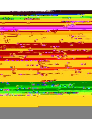

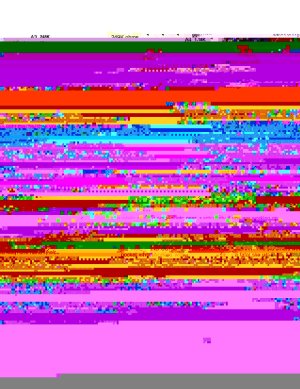

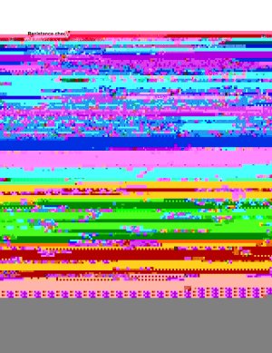

I am getting 120 VAC at the power terminal switch and ect, so you saying it might be a wrong power transformer? Is there a specific test I can do to determan that?
Could you also send a couple of 220 ohms resistors? I had to replace one, it was reading around 370 (A side) and another one is close to 300 ( B side). Should I contact Eileen to get this expedited?
Here is some additional info:
Pics attached show resistance and VDC voltages I'm getting.
Few other things i found:
1. 220 OHM resistor read 350 ohms on A side at A3, I replaced it but with now difference to the readings.. Could that be a problem?
2. In places I should see 0 ohms reading I show 0.1 to 0.3 ohms.. Is that normal?
3. My plate chockes do not have a red/black wire (as described in manual) that supposed to connect to 17L & 19L. It's black..
Thank you all for your help
Roman
    • Posts: 9735
Reply #11 on: May 02, 2013, 05:24:35 AM
I have asked Eileen to send you the proper transformer. The 220 ohm resistor value is not critical, and you will never measure exactly 0 ohms on the ground connections. Anything under 1 or 2 ohms is fine there. Not sure what is up with the plate choke wire color. I will investigate when I get to the office.
