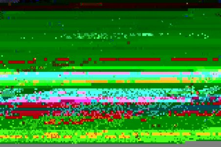

Wrapped it.  Messed up the first one with the logo but have a nice tight wrap this time and shrunk it down with a heat gun.  Will apply logo tomorrow or next day and post again.
The front edge is perfect just looks weird because of the flash.
Let the FUN begin!

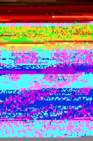

And with the decal. First attempt had the swoosh over the vent holes and I just didn't like the way it looked trimmed up.  So I made a bigger swoosh and dropped it down a bit.
Not 100% happy with it but its pretty cool I think.

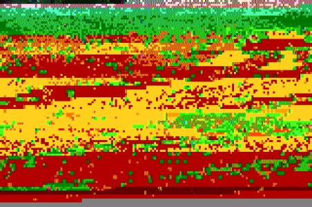

This is kind of what it will look like.   No nine pin socket because the kit is missing a couple 4-40 nuts but I can pick them up locally or probably have a couple laying around.  I took two off the Extended Foreplay 3 upgrade last week and damned if I can't find them.  Probably tossed them.
Volume is a 100K Goldpoint.
John

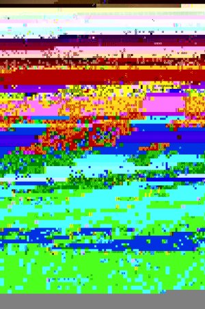

Sneak Peak of what its going to look like.  Mind you I haven't started the build up yet.
And the transformer is going to be black on the sides and white on the end bell.

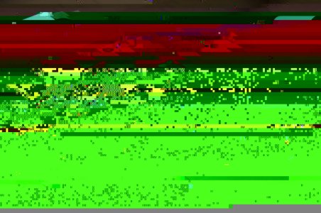

And having entirely too much fun here I have the transformer painted up.  Tried to vinyl wrap the end bell but too small and too many complex curves.  Painted instead.
Little glare off the tubes on the chassis but too tired to fix the lighting.  I guess tomorrow starts the wiring phase.
And obviously I have to sand the glue off the base and stain it.
John

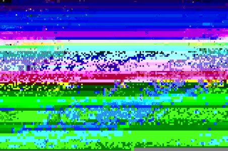

Not real exciting but slowly getting her together.  As Boston sang "I'm taking my time, I'm just moving along......."
Nice instructions.  The Bottleheads are getting much better at the layout game.  Having not built a kit in years I can really tell they've honed their craft.
Except for the two LED's on the 9 pin socket, that is..........crap.  I got it.  But crap I'm gonna see double for an hour.
Now starting on the power supply and I'm building in the Speedball as I build this up so leaving the resistors out.
John
