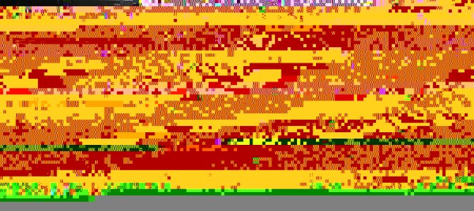

Offline TubeTim
    • Posts: 18
Reply #10 on: August 24, 2013, 03:37:55 AM
Hey Joshua,
First, my compliments on an very well written manual.  Also thanks for the prompt response.
Thanks for pointing out the manual has a picture of the front plate, I should have looked for that.  Be that as it may, the manuals front plate does not match the one here, please see attached image.  It is missing the 0-db position or the coarse.  This is NOT a big deal as the 0-Db position will not be used so the difference will never be apparent.
By pictorial, I meant the photo on page 71.  There one of the attenuators has what looks like 2 diametrically opposed terminals unused compared to the other (1 O'clock and 7 O'clock position).
I'll leave the switches both set for 6 positions and "solder on".
Best Regards,
Tim
Reply #11 on: August 24, 2013, 03:50:58 AM
A picture is worth... you know.
Tim seems to be spot on.  Maybe the ID panels shipped were wrong?
Offline fullheadofnothing
    • Posts: 1487
Reply #12 on: August 24, 2013, 07:11:52 AM
Huh. Well, I guess the file got botched. I'm blaming PB, mostly because he's on vacation right now. Next time I'm in the office I'll check if they're all like that. Also, for what it's worth, the switch with the blank spots is the switch that has all 6 positions identified. If that confused you, welcome to the brain rot of switching back and forth between the top and the bottom sides of the chassis...
As for why there are empty spots, I think it would be because all the resistors on that switch go to ground, so one position is not grounded to give full output. Note as always that when I am talking about anything electrical, it should be taken with a major grain of salt, and hopefully a smart person will come along soon enough to correct any mistakes and make fun of me.

Offline bernieclub
    • Posts: 114
Reply #14 on: August 25, 2013, 07:33:39 AM
Just unpacked my kit.   I got the same attenuator plate....it appears to be missing the 0db mark on the course adjuster.
