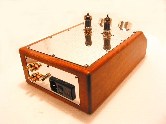

I have used Corcom PS0SSSSXB in Bottlehead and my own DIY designs for over 10 years with very good results. Here is a picture from around 2002 of my custom version of a Foreplay II.
(https://forum.bottlehead.com/proxy.php?request=http%3A%2F%2Fwww.wardsweb.org%2Faudio%2Fforeplay%2Fimages%2Fc3b.jpg&hash=0c00f95ea8b1434cfc048f3b54d5edad77516626)

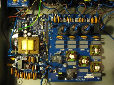

I'm still experimenting with this myself, i only recently picked up a second hand Belkin PureAV.  Its just a basic passive filter inside with a some common mode chokes, but with four separate channels so in theory its providing some isolation between devices.  The reason i bought the unit was to have something sitting in front of my Bottlehead amps.  I do plan to modify it (surprise surprise), and move my two felix filters into the same enclosure.

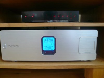

The voltage monitor is interesting, even back in the days of using opamp based headphone amps i always knew they sounded best from ~1am to 6am in the morning, now i can clearly see thats the only time of the day where i get 240v, from 6am to midnight my mains is down ~230v.

The unit i got is the PF40 which is the four channel version, if you look at the internal pic i posted, the far right channel is the "digital" section with two chokes, the two channels in the middle are identical (audio&video) except for the left one is switched, and the far left channel is also switched and only has two caps and a ferrite bead, thats the "high current" output.
The two switched channels can be turned on/off with the power button on the front, or you can feed it an AC or DC signal in the back to trigger them. The delay function is a set time, once triggered it waits 3-4 seconds before turning on those two channels.
The far left board has a metric crap ton of MOV's to withstand a lightning bolt from the hand of god, and the rest of the board is a mystery to me.  All i can make out is the transformer runs a positive and negative 12v regular to feed a quad channel opamp, what its doing i have no idea. Apart from the simple remote trigger logic, the front panel displays voltage & current, and that's about it.  Its a nicely made unit but there is nothing clever or "expensive" inside the unit, i would say the bulk of the cost is the pretty enclosure.   The reason i liked it was up until now i was making separate units for different equipment, at least now i can have it all inside the one box, and with the PF40 there is plenty of room inside the case as it has two less channels than the PF60.  For example there would be plenty of room to mount a Hammond 193 in there connected to a few outlets.
