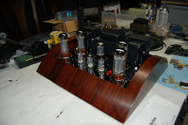

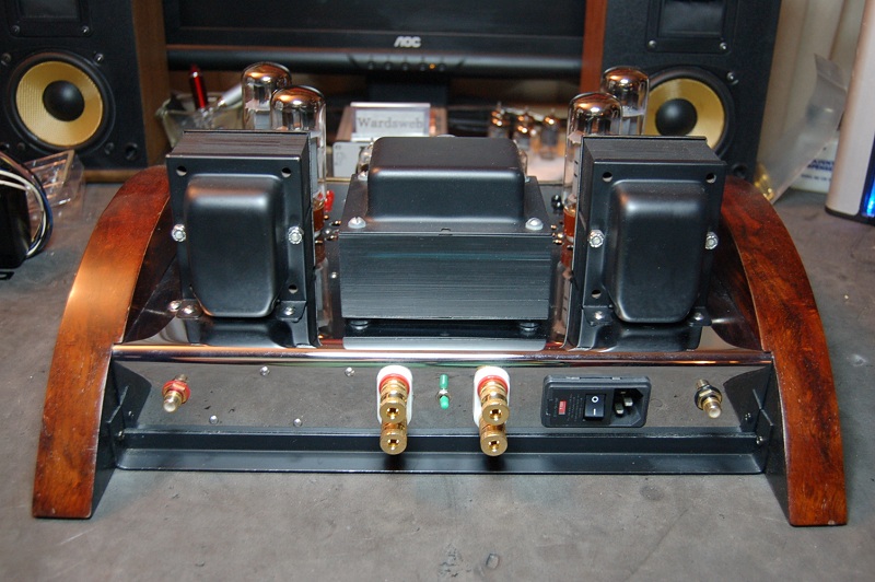

This is what I came up with for building a modern version of a Dynaco ST-70. The only original parts used were the output transformers. Everything else is new. I upgraded parts and driver board. I drilled and punched a chassis for the new layout and had it chromed. I build a new cabinet out of Baltic birch and veneered it in cocobolo. I was inspired after the Quickie I built with a similar cabinet design.

Can you build me one?
That is really pretty, whose driver board did you decide on?

WOW !
That is incredible.  What are the two red topped things between the output tubes and the driver tubes?
I used Shannon Park's board. You can see in depth details on my website:
http://wardsweb.org/audio/ST70/

Beautiful work!
How hard was it to do the veneer?
Not hard at all actually. The side you glue and then trim. The top is one piece. I glued it first and then cut out the center.

WOW !
They're several test points on the chassis used for setting bias. The original amp had the tube socket on the front. I opted for a some nicer tip jacks.
Reply #9 on: March 26, 2010, 11:25:18 AM
I take it that the right and left pair of output tubes are still biased together?  I got a schematic some time back that allowed bias for each tube and allowed using non matched tubes.

Reply #12 on: March 27, 2010, 06:08:13 AM
The Stereo 70 is 35 WPC.  That was part of Dynaco's numbering scheme.  The parts are mostly being cloned by a number of companies.  Luther bought his "junker" ST-70 for the old, desirable, cloth insulated  wire output transformers.
If you use the link he supplied in reply #4, you will find a parts list.
And with a few more pictures of the inside goodies and this MANUAL downloaded you can build your own.
