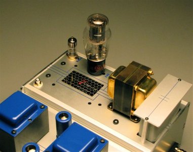

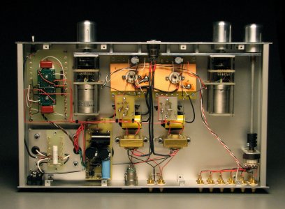

Reply #9 on: November 09, 2020, 09:13:54 AM
After reading about the Soul Sister/Kugelis proposed linestage in the Bottlehead newsletter, I began ordering and saving parts for the build. The first item was a pair of MQ Cobalt B-7 trannies for the output of the 6C45 tubes, and a pair of Transformer Volume Controls from I.A.G. which used Sowter trannies. Chokes to load the tubes and a dual power supply filled out the parts I was saving for a build that I had no time for. Good Luck for me at the Vancouver 2006 VALVE State of the Art Conference included Dan introducing me to Paul Birkeland, who was building Bottlehead proof-of-concept pieces for them. Paul built a beautiful enclosure for my linestage, including knobs a friend machined for me. V-caps provided coupling. This piece has been dead quiet and super reliable for 14 years of service, and a JJ 2A3-40 stereo amp followed, using MQ Co/M6 Pinstriped outputs along with a matching Eros phonostage using MQ trannies and chokes. Soon, Paul will be finishing up a pair of Jagers for me that will replace the Blumenstein Orca/BUF Sub combo that is playing now.

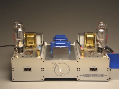

Reply #11 on: November 20, 2022, 01:57:02 PM
My Soul Sister/Kugelis MQ B7 cobalt linestage is now driving a Kaiju built by PB with the DC power supply and JJ 300B tubes preceded by Cu V-caps and driving the Bottlehead speakers. I am more than satisfied with the enlarged soundstage in my room, and the effortless presentation this combination gives. My "Final Music System" is now complete, thanks to Paul and the Crew at BH.
