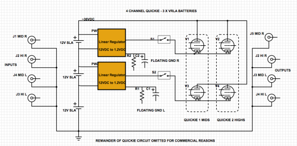

Reply #14 on: May 28, 2014, 11:52:48 PM
The 2 Quickies are up & running and they sound just wonderful.  I'd like to keep the battery concept but the above quality problems compound with both my Quickies in one chassis, quite apart from housekeeping 12 cells.   Yuasa SLA's are cheap here.  Would this idea work to provide the right voltages with 3 separate grounds?  The LM317 based reg boards have been suggested here before and at their price, not worth making oneself. Apologies for basic questions but as a mechanical engineer, I struggle with electrickery.
