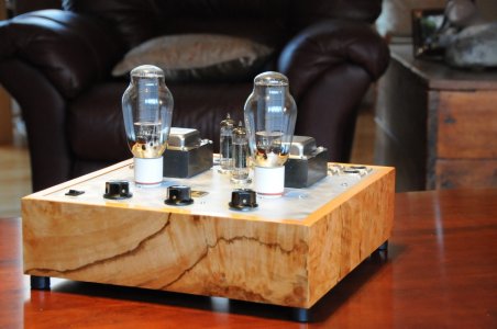

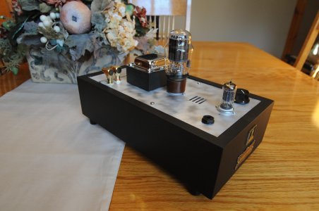

If you want to paint a base black, I would recommend using a good quality flat latex paint. Use just a paint brush. Unless you have equipment to spray paint, it is difficult to make a nice finish when using gloss black paint, - either in latex or oil. You will find attached my first Bottlehead kit: a Crack.  It is finished with flat latex. If it gets scratched [or bruised], it just takes a minute or two to re-apply a quick drying latex.
When I did my Paramounts and Bee-Pre, I finished the bases in Pimento Wood Burl veneer.  That is a lot more work, but the results are great, - if I humbly may say so.  If anyone is interested, I shall be happy to advise on how to do that process.
Photos are attached.

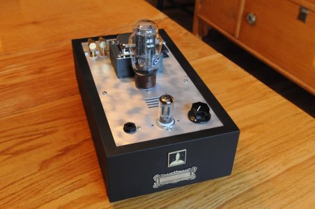

Or you could apply a black wood dye and get a nice ebony look that lets the natural grain peek through a bit.
(https://forum.bottlehead.com/proxy.php?request=http%3A%2F%2Fwww.trancho.net%2FHC%2Fcrack_1.jpg&hash=b47f82e31a2ac9ad80f45e2dfd56afc69ea06e6e)
That looks great.  I think I'll do that.  If you have a specific brand of dye recommendation and/or other tips please share.

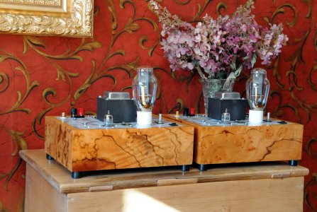

Jamie, here are the Paramounts with the Pimento Burl bases
Guy
Guy
Beautiful work guy and a real credit to you.
