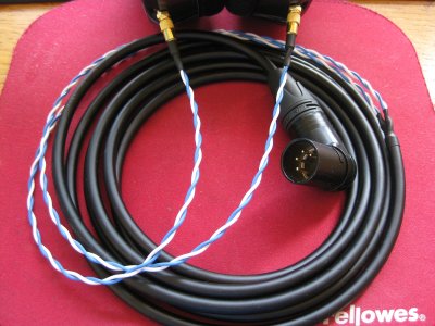

Have any of you replaced the cable?   The stock one makes an annoying microphonic sound when you rub the cable which i don’t like, and i have an XLR plug here to make a balanced cable, just don’t have the nerve to
snip the end off the supplied cable.  Basically i'm looking at the extra headphone connectors in the box and an XLR connector wondering how best to join them. I have never made a headphone cable from scratch before but i did find this on eBay http://www.ebay.co.uk/itm/5meters-1-0mm-high-purity-silver-plated-OCC-teflon-wire-for-audio-DIY-0-26x19-/320998604353?pt=US_Audio_Cables_Adapters&hash=item4abd01fe41 which with a little bit of weaving should end up looking like the stock cable.  Any thoughts?

This link (the rest of the page is a trove of great balanced cable DIY info as well) is exactly what you're looking for. Converting the stock cable is as simple as cutting off the stock adapter and resoldering. The stock cable is already balanced to the jack, then both grounds are soldered together. Otherwise, some Canare Star Quad is probably what you want.
http://robrobinette.com/BalancedCable.htm#Convert_HE-500

Canare 4 core looks like an interesting option, seems readily available and sensible money too, thanks!
I noticed the stock cable had the four cores but could'nt bring myself to chop it up.  For example here is what i did for my HD650's, cheap aftermarket cable i bought second hand for £30, snip, splice on XLR = one cheap skate balanced cable ;)
Reply #13 on: May 02, 2014, 08:01:08 AM
And were done, i have some paracord on order to pretty it up but for now its fully functional. I'll do some testing over the weekend to compare balanced vs unbalanced and see what changes i notice if any.
Reply #14 on: May 07, 2014, 07:17:16 PM
....after a week using the new cable i finally flicked the switch into balanced mode and there is a noticeable difference, more of a difference than i remember when i converted the HD650's. Similar to the HD's i 'm finding the low end bass more controlled, and i would even go as far as to say there is more/better sub bass then before.  Certainly i am more aware of deep bass frequencys than before, or maybe that's just a result of being better defined.   I could also convince myself they sound clearer and less muddy overall, either way it seems it was a worthwhile en-devour to convert them.
