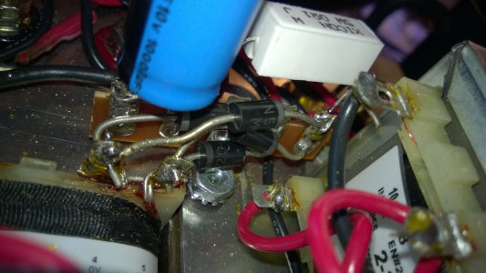

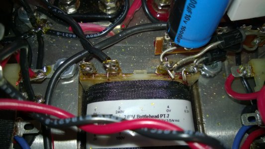

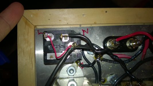

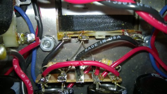

Here are some picks. Sorry about the mess - I'm trying (in vain) to clean up as much as I can without a full rebuild.

Sorry, going back to your original post, i assumed when you said terminals 4 & 5 you were talking about the heater supply not the high voltage supply. The HV supply terminals should give you a very high reading and changing as the caps charge from the meter. From my notes i was seeing over 100k and counting so .4ohms is certainly not right. I dont see anything obvious in the attached pic, can you post a few more from further down the power supply trail..
Also double check the heater diodes, one of them i cant really see but the leads for the two going to terminal C5 look very close together, just make sure none of them are contacting each other.

I checked the diodes after my post because I was wary of them too, but all is clear despite being close. I've moved them a little to create more space as well.
