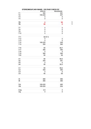

OK - just went through the manual - are you talking about the LM431 adjustable shunt regulators?
Then I got something to share -
1.  When turning the amplifier on there is always a couple of seconds with both hum and hiss.
2.  There were some points when doing the DC check when first firing the amp up that got me a little bit confused - especially the measuring points around the circuit boards...
I will attach all the DC voltage checkpoints in a PDF document - please let me know if you can see if there is a problem related to the items you are talking about....
Signal Source : Thorens TD 124 MkI / SME 3012 / Denon DL103
Setup : Quad 44 / Bottlehead Stereomour / Altec 604E in DIY 612C cabs
Reply #7 on: May 31, 2014, 01:29:35 AM
That is the 431 (LM431) that they mean.  They have new ones that meet the spec, the bad lot didn't.  Just contact replacementparts (at) bottlehead (dot) com or fastest thing is to call Monday.  They are very quick about getting parts out.
