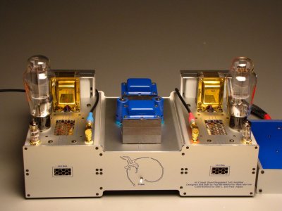

Hey, y'all.  Just ordered the Eros, and a pair of the new Cinemag CM-1254 step-up transformers. Anyway, here come the questions: who mounted step-ups in their Eros? How did you attach them? Where did you place them? Did you experience any problems with noise or hum in your setup? And if so, how did you deal with it?
Paul Birkeland built a custom Eros for me which utilizes Altec 4722 SUT's mounted on the rear panel as shown below. This mounting is as far from the Power Supply as possible. I took it to a Salon here in Eugene to see if there would be hum with the Altec SUT's. Turns out there was none heard when we had it running with a lo-output cartridge. YMMV, of course, but Paul's choice of location was very clever.
Cheers, Hank in Eugene
