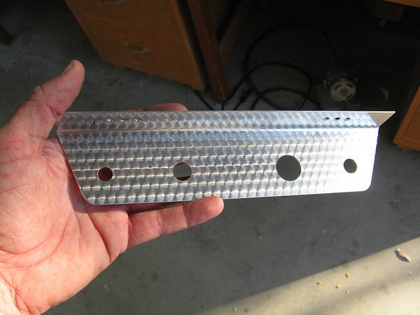

Reply #6 on: August 17, 2014, 07:06:25 PM
Metal burnishing, looks great but its a lot of work...
(https://forum.bottlehead.com/proxy.php?request=http%3A%2F%2Fwww.overthehills.com%2FRV-9A-Project%2FFirewall-Forward%2FEngine%2Fi-5w9GZTp%2F0%2FM%2FIMG_3816-M.jpg&hash=2538c069d3e3ab686c0025bd3434f2aadf2555e1)
