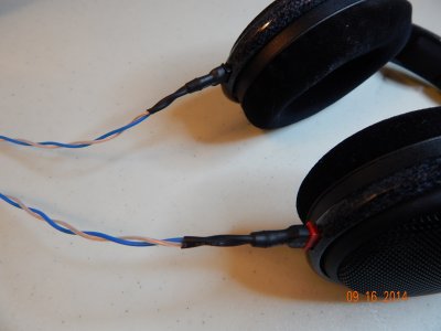

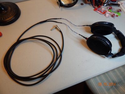

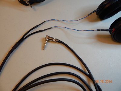

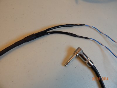

I DIYed a replacement cable for my HD600s and found it to be a significant improvement over the stock cable.  I don't know how this upgrade compares with the much more expensive replacement cables from Cardas , Double Helix, etc but I really like the improvement.  The cost of this cable was very resonable AND you get to make it.
The cable is Mogami 2534 microphone cable ($2 per foot from Sweetwater). The connectors to the cans were Cardas brand bought from Dedicaterd Audio LLC for $24 (this included the shipping).  The Switchcraft right angle 1/4" TRS plug was from Mouser for $6.30.
The cable is four conductor (2 blue and 2 white).  I twisted the two blue conductors with the metal sheathing and soldered this to the sleeve (ground) of the 1/4" TRS plug.  I soldered one of the white wires to the Tip (Left) and the other to the Ring (right) of the TRS plug.  At the other end I ohmed the wires to ensure I soldered the Tip to the Black (left) Cardas and the Ring to the Red (right) Cardas connector.  BTW, the large pin is ground (for the blue wire) and the small pin is positive (for the white wire).  I used "cable pants" at the "Y" and heat shrink to secure all of it together.
This was relatively cheap, easy and fun to do and performs much better than the stock cable.
If you have some time and curiosity this will put you back $60 -$70 dollars but you might find it worth it.
If you don't think there is sufficient improvement go ahead and spend several hundred dollars on a replacement cable from Cardas or Double Helix or elsewhere.
Here are some pictures of the finished product.
« Last Edit: September 15, 2014, 11:32:59 PM by Adrian »
