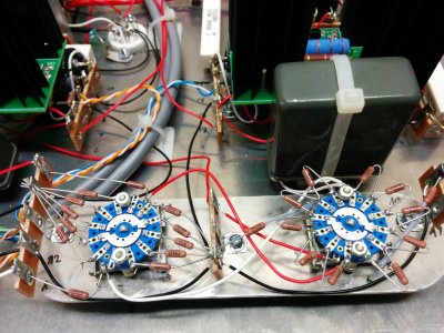

The BeeQuiet was a fun build. It was relatively easy, but that is mostly thanks to the excellent instructions.  Attaching a photo :)
Thanks for the photo, just what I was looking for as I start my build. What are the caps there? Some vintage Russian?

Reply #11 on: September 02, 2014, 07:30:19 AM
They are Russian MBGO 10uF 300V caps.  If you install them, be careful that they're heavy. They needed some RTV Silicone to support the base of the ties. I actually thought the caps were the problem yesterday and measured them. They both measured 10.5uF and their ESR, dissipation factor, and Q were matched and very good.

Reply #12 on: September 02, 2014, 08:04:23 AM
Thanks for the info. Something to consider!
