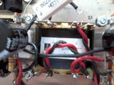

Thanks, Paul.  Hope this photo attaches.  It is not very good, but shows the secondaries connected together.  A resistor and the ground to the filaments are disconnected to isolate the power supply back to the first filter cap.  Something else I neglected to mention:  When I check for resistance across the B+ secondaries, I get Megohms, really an open circuit.  The primary shows 12 ohms on my meter, the 6.3V winding shows .5 ohm, which sounds correct.  I would expect the 150VAC secondaries to show about 18ohms.  My friend's soldering looks good throughout the build.  I hesitate to blame the transformer yet, not quite ready to make that leap, but I am really puzzled.
    • Posts: 20297
Reply #3 on: September 13, 2014, 01:38:40 PM
That resistance reading is very odd, especially considering there are two secondaries there, and you only need one for the transformer to function.
It's also very odd, because a reading in the megaohms would mean that you shouldn't get any AC voltage reading out of those windings.
Can you check to be sure that the wires wrapped around the base of the transformer solder tabs are still connected and not broken?

The HV secondary windings appear to be connected in parallel, which would yield 150VAC(?)  But I need 300VAC going to the rectifier circuit, correct?  I must not be understanding how the connected windings combine.
Thanks again for the help.
-Scott
    • Posts: 20297
Reply #5 on: September 14, 2014, 07:20:11 AM
161V AC is the specified AC voltage that you should see, 150V is still plenty for the amp to operate.
Paralleled windings give more current but the same voltage.
Windings in series give twice the voltage but only the current that a single winding could deliver (the PT-3 in the Crack must *never* have its windings wired in series).

Thanks, guys.  I was thinking 300VAC P-P would yield about 212VDC.  This must be 150VAC RMS?  The transformer on this build looks good from the outside, wires coming out of the windings are soldered to the tabs.  I still get an open circuit across both 150V windings no matter what combination I check.  Even measured the resistance on windings of the power transformer on another build I have to make sure I knew what they should look like.  Primary and 6.3V look good.  I sure don't understand how this can be, but there it is.  Will ask my friend who put it together to call or email Bottlehead and see what can be done.  Thanks again for the help, will post again on this puzzler if I find anything out.

I brought my friend's build back to him today and demonstrated to him with a multimeter the open 150V windings.  Had him measure the resistance on all the windings himself.  The ends of the windings can be seen soldered to the tabs.  This is simply a bad transformer.  If he contacts you, will you send him a replacement?
