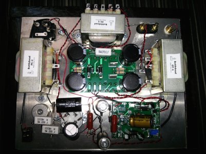

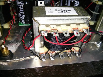

Edit: I found a thread in the Paramount section and the two LEDs are indeed belong to a 2A3 version. Strange that I read all the 2A3 parts and couldn't find where two LEDs are used. Probably they're belong to an older 2A3 wiring.
By the way, my 300b Paramount build is 220V and I followed PJ's advice to use the 2A3 choke wiring (attached photo). All four LEDs on the C4S board and both tubes are on. Resistance check is fine. All the non * ones are correct, the * ones are slightly off but is similar to an "Doc B approved" set I found here. The voltage readings (AC voltage of 223VAC rate) are mostly good except for a few falling outside of the 10% error.

So a few questions... before I plug in some music of course.
- The OA starting voltage fluctuated a bit around (and above) 350V a few seconds once I turn the amps on, but settled in at 300V after 10s or so. Is it acceptable?
- Should I be worry about the mismatch Kreg readings (more than 10% error)?
- I adjusted the potentiometer to read 175V at the OB pad, and I thought the reference reading (at OB, and 19?) should be 175V but it is listed as 200V. Am I missing something?
- I didn't do the hum adjustment since it's tricky to do that with the side of the 300b tube. I supposed I can listen to the speaker white noise and do that later without a meter?
« Last Edit: September 23, 2014, 08:28:38 PM by Mach2 »

How was my voltage check? Do they look OK enough (especially the ones on the boards) and up to specs?
PH
Reply #6 on: September 23, 2014, 08:11:02 PM
   .  .  .   How was my voltage check? Do they look OK enough (especially the ones on the boards) and up to specs?
According to all the manuals I have if you are within, plus or minus 15% you pass.  Since I don't have the manual you will have to do some calculations.  Divide what you read by the target in the manual.  If the number calculates more than 15% high or low post only those out of spec.
You're exactly right. Most of them are within the range given my low input of 220V instead of 240V, except the ones on the C4S board which are about 20% or 30% off. I'm a little concerned this time because I don't know what to expect with my 300b build with the 2A3 wiring scheme, and partly I read from a post here from someone with "out of specs" C4S readings due to bad IC components...
