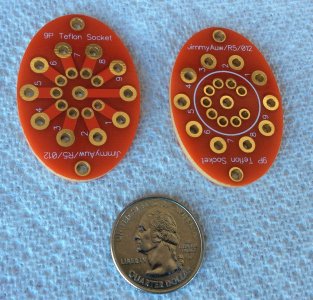

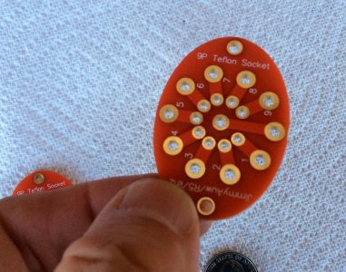

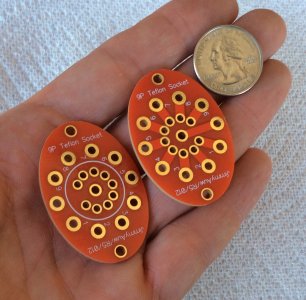

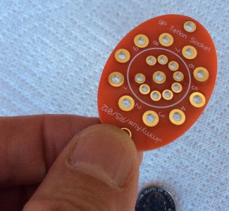

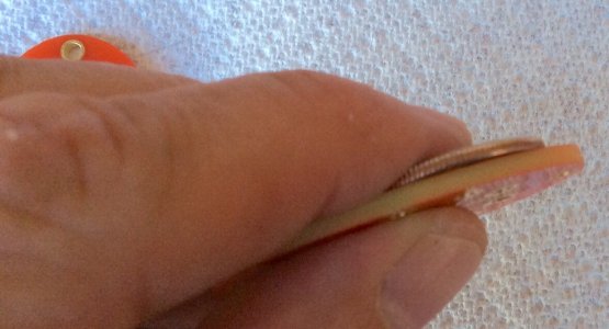

When I saw these 9 pins from Auw Jimmy I had to get one for my Crack build.
I got 2.  Beautifully made, gorgeous to look at.   Take a look

I guess it's all perspective. I looked at the pictures from the standpoint of tech support and immediately thought about the potential for nine additional bad solder joints.
Reply #5 on: September 30, 2014, 07:22:06 PM
They are difficult to solder onto the socket as the pins soak up a lot of heat, especially on the center terminal.  They are also a pain to use when you have to solder more than one wire per terminal due to the size of the holes.  On the plus side the tube sockets are of a much better quality.

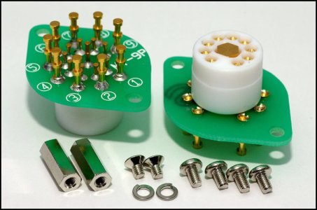

I thought more folks here were using these 9 pin pcb boards from different sources like theses.  One for the Yamamoto teflon socket. This other from Parts connection.
http://www.partsconnexion.com/CONNEX-74342.html

 I've used those one's from Partsconnexion it's a PITA to work with the holes for the hookup are far too big.

Where might one get those extra pins for the outer holes?
