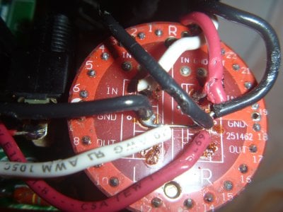

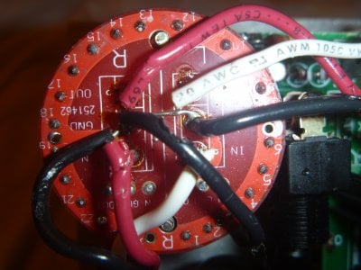

Ok, I probably just should have left the Crack alone as it was working perfectly and I had no complaints. Unfortunately the urge to tinker got the better of me and I installed a VA Labs 100k stepped attentuator.
All the resistance checks are working, except for Terminal 10 which is 0. Looking at the wiring, this is the left channel and since it reads 0, I assume I am grounded somewhere where I should not be.
The steps I have done are the following:
1. Marked in / ground / output as per PB's advice. http://bottlehead.com/smf/index.php?topic=5542.0
2. Grounded the 2 channels on the attentuator together. Refer to the first picture for wiring on the top of the attentuator.
3. Removed and redid the braided wires from the RCA jacks, and soldered white and red to the inputs of the attentuator. Ground was attached to the outer ring.
4. Removed and rewired the ground wire from the headphone jack to the attentuator. The second picture shows the wiring on the headphone jack. Everything is per the manual, with the startup voltage mod added. The ground is attached to the top of the outer ring on the attentuator.
5. Wired the black wire from T3L to the bottom outer ring of the attentuator. This can be seen on the third picture.
6. Removed and rewired the red wire from A7 to the output of the attentuator.
7. Removed and rewired the white wire from A2 to the output of the attentuator.
My first though was that the white wire at the RCA jack must be the culprit, as it was difficult to remove all of the solder from there. However, I believe that if the connections was problematic I would not get such a nice 0 ohm resistance. The resistance chekcs at the RCA jacks are both very close to 100kOhm.
Why would only one channel be grounded? I would think that if my grounding was wrong at the attentuator, then both channels should be grounded.
Any troubleshooting advice would be appreciated.

Reply #1 on: October 02, 2014, 11:45:21 AM
T10 is in the output stage rather than the input/attenuator stage. So my hunch would be that there is maybe a short at the headphone jack. Curiously it looks like the right channel red wire that goes to T6 is shorted to the black wire, but the left channel white wire that goes to T10 looks OK.
You might want to pick the amp up and shake it a little and see if maybe a cutoff bit of wire falls out.
« Last Edit: October 02, 2014, 11:53:16 AM by Doc B. »
