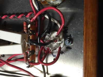

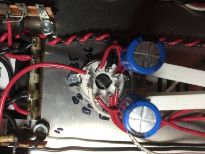

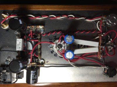

Reply #3 on: February 19, 2015, 04:44:34 PM
FWIW, here's a few pictures of the wiring.  I've checked everything more than once and also tried re-flowing my solder joints (along with a mechanical connection check).
