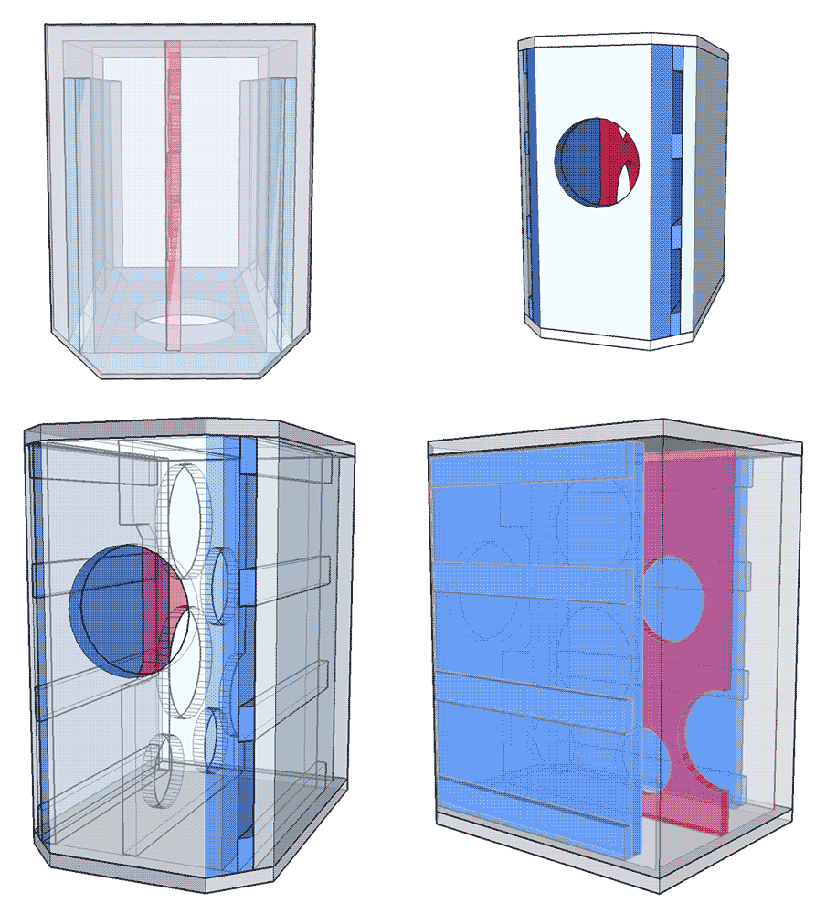

After losing way to many hours on the different forums and lots of changing my mind I've settled on the dFonkinfx enclosure for several reasons which included.
1 consistently favourable results reported for this cabinet type
2 said to work better with Sets amps and low watts
3 They have a similar footprint to my current bookshelf speakers
So pics of progress so far plans and timber.
Normally birch ply is recommended but I had a offcut of 18mm mahogany marine ply left over from a job so as it cost me nothing I'm using that instead, its way better quality than the Birch ply but don't have a clue how or if that is relevant or not to the end results.

Link to plans
http://p10hifi.net/FAL/downloads/dFonkenFX-0v8-map-020709.pdf
(https://forum.bottlehead.com/proxy.php?request=http%3A%2F%2Fp10hifi.net%2Ftlinespeakers%2FFAL%2Fbox-plans%2FFonken-3D-B.gif&hash=f1fdd3b7b3d6d7912496807401221e9ec4240b20)
A completed cabinet of how it should look

It would be better to have 2 or 3 horizontal braces and a top brace but otherwise they look sharp.
Something like this...
(https://forum.bottlehead.com/proxy.php?request=http%3A%2F%2Fgr-research.com%2Fpics%2Fbox5.jpg&hash=3cc7fb4047bc9d4663f7b385fe085938876d2e40)
I see where you are going. I think the effect of the sandwiching of the baffles between the two vertical sides is fulfilling that particular role by creating a row of I beams which is going to make it pretty strong and resistant to flexing
The ply I have is 18mm and the distance between the cabinets internal sides and the middle offset baffle is only 70mm'ish so its going  to be pretty ridged.  I suspect it would probable a take fair old weight on the top 250kg for sure!
What is interesting in your example and what I have been wondering about is the radius to the holes in the centre baffle Some builds have them some builds do not? So a little more digging on which way might suit is still in order.
Cheers
« Last Edit: November 25, 2014, 07:42:54 AM by JamieMcC »
Offline corndog71
    • Posts: 593
Reply #4 on: November 25, 2014, 10:05:50 AM
I believe the radius on the internal holes helps reduce turbulance within the cabinet, against the back side of the driver, as well reducing vibration within the brace/cabinet.
Another good idea is to radius the inside of the driver hole.  This does reduce reflections back onto the rear of the driver.

Thanks, chamfering the back of the driver hole I have seen mentioned in some of the Fonken build threads and had planned on doing the same.
