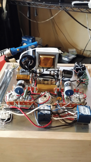

First of my 2015 projects done.  Mostly stock with a few changes that I had on hand (choke and bypassed last power supply cap, and upgraded Clarity caps).  Next in line is a Tode or SmashUp, which ever delivers first.

Nice work Alonzo!  But it is no surprise.
The combination of volume and balance is so rare these days.  I think balance controls are disappearing.
I had to smile seeing the Obbligato oil and polypropylene film cap.  They are so good and cheap.

Nicely done!!  The 270 ohm PS resistor is just crying out to be replaced with a choke.  What did you use to bypass the last PS cap, the Obbligato value? My Smashup will likely be delivered today. (short hop from Seattle to SF Bay Area!)  I will get that in and then order the choke.

Hi Geary, it's a 2.2 Obbligato oiler, I don't have a scope anymore to see if it made a difference but I've used them before and it's a cheap experiment.

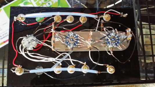

Along with the SmashUp I'm going to put in this passive attenuator (modified BeeQuiet).  Will have to make some calculations and change some resistors, I think, but I don't need the balance pot after all and this was the passive I had in the system (reuse as much as possible or it just clutters up the garage).

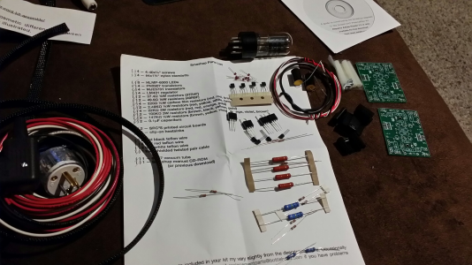

The Smashup is segmented, but PB posted that there not enough current headroom to drive the C4S and the OD3.
The circuit is part of the kit, and is included with the manual.
There isn't really enough current available in the stock power supply setup to run the C4S boards and the 0D3.  You'd really want to replace the 1K 25W resistor with a 50mA C4S, and the thermal load on that setup would require a massive heatsink. (Just look at how massive that resistor is in the first place!)
