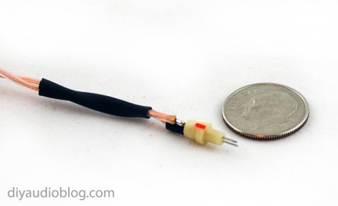

Reply #3 on: January 20, 2015, 10:41:33 AM
Those pins are tiny for sure! Here's a pic of the Furutech HD800 connector interior compared to a dime:
