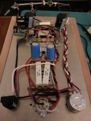

Offline denti alligator
    • Posts: 1156
Reply #6 on: January 21, 2015, 04:36:12 PM
Voltage isn't right. See above for resistance inconsistencies. Tubes both glow. Only A8 LED lights up. The A3 one does not.
Voltage issus:
T5: 149
T9: 147.3
A1: 148.6
B4: 148.7
B6: 148
All others are within range. What might I have done wrong?
- Sam
    • Posts: 1156
Reply #8 on: January 22, 2015, 01:47:00 AM
Do both halves of the 12AU7 glow?
No, it don't think so. Just one. The one closest to the power input/back of plate is glowing; the  one closest to headphone jack/front is not.
I just double checked all the wiring. Seems to be correct. I don't see anything unsoldered. I reflowed and added a bit of solder to A3.
That LED still doesn't light up.
« Last Edit: January 22, 2015, 02:41:32 AM by denti alligator »
- Sam

    • Posts: 20305
Reply #10 on: January 22, 2015, 07:42:45 AM
That LED won't light up if its half of the 12AU7 isn't glowing.  The red wire to A4/5 provides the heater voltage to make this happen, double check that this connection is well made.
    • Posts: 1156
Reply #12 on: January 22, 2015, 10:05:31 AM
Have you checked if the LED's are correct in orientation?
They are. I'll double check the wiring in about an hour when I get home. What do the high voltages at T5, T9, A1,
B4, B6 suggest?
- Sam
Offline Jimb0
    • Posts: 304
Reply #13 on: January 22, 2015, 10:35:18 AM
Don't take my word for this but it sounds like some of your resistors aren't bringing the voltages down to the proper levels. You checked the LED's on the 9 pin miniature socket as well right? That was the one that I missed last time when I had the bands wrong which didn't bring the voltages to the right level. Also, check the fast/soft recovery silicon rectifiers (black/silver banded tiny things) and make sure they are positioned properly.
One last thing, make sure no wires are touching any other wires. This could lead to shorts which will cause your Crack not to work properly.
Posting pictures might help us find the cause of your problem.
« Last Edit: January 22, 2015, 10:37:33 AM by Jimb0 »
    • Posts: 1156
Reply #14 on: January 22, 2015, 10:59:22 AM
I reflowed A5 and A6. Still not working. Any other ideas?
