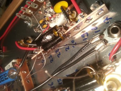

I am building my Reduction as we speak. Everything went pretty smooth ... until the last moment.
I was soldering the stack of dayton capacitors near the A tube, which was a bit of a difficult angle.
When the soldering was done, I looked at the stacked capacitors near the B tube and ... I hit the stack with my soldering iron :( .
One side was already done, the other lead was stil free.
I did measure it (put my multimeter on ohms and after that to volts dc and then you need to see the voltage gradually discharging).
I know the capacitor is gone  :( .

Yeah, that sucker is fried. A tight tolerance 0.01uf polypropylene cap rated for at least 200V will work in its place, or you can email replacementparts(at)bottlehead(dot) com regarding replacements.
