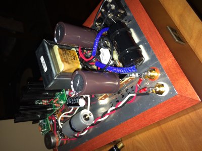

Here's what you see-
Crack with Speedball
Padded down volume control
Teflon audio bypass caps
Mundorf MCap Supreme power supply bypass cap
Cardas RCA input jacks
PEC 100k Stereo log potentiometer
Here's what you don't see- Tung Sol 5998 and Mullard CV4003
Crack/Speedball & SEX 2.1/C4S

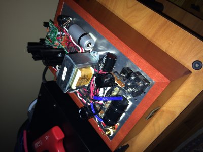

Ok- added another mod- put a 270 ohm choke (Triad C7-x) in the power supply. I needed to use 1 inch standoffs and drill 2 holes in the top plate. Unsoldering the 5w 270 ohm resistor and soldering the choke's leads was a little tight but not bad.
As usual - now I'll say I'm done.
The choke is a good mod
So here's what I'm running-
Speedball, padded down volume with PEC volume pot, cardas RCA jacks, choke in ps, Teflon audio bypass cap, mundorf bypass cap in the ps
Typical tube compliment is Tung Sol 5998 and Mullard Cv4003 but now I'm using a GE 6as7g and a Mullard 12au7 (these are my backup tubes and decided to switch them in for a while to great effect)

Reply #8 on: May 11, 2015, 03:07:38 PM
Triad choke mounted on 1 inch standoffs
Ok- so I replaced the 1st PS cap with a 470uf 250v Nichicon, eventually going to replace the 2nd PS cap similarly. The final PS cap is going to be interesting

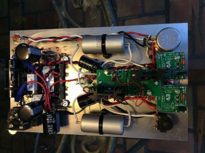

Here it is with the 470uf PS caps for caps 1 and 2
Yes- pretty busy in there

Great mods, but I  have a question about them. I would like to do some of those mods myself, but I wandered how do you connect them and what components have to be removed? I have a crack with speedball now.
Do you have a drawing or detail photo's?
Can you describe the sound?

Some mods are straight swaps- new part for the old part. Bypass caps are another story.
The new RCA jacks made no difference. The speedball made a big difference as did bypassing the audio caps
Offline Nathan
    • Posts: 205
Reply #14 on: June 21, 2015, 10:53:30 AM
I moved the speedball boards to do the new headphone jack because I lengthened wires. The boards were replaced to their original positions. The most challenging installation space-wise was the choke. See my photos in this thread to see the installation
