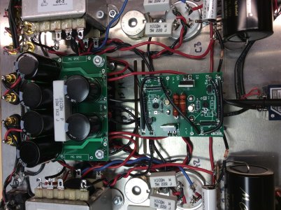

OK I made the changes (see attached photo).  Here are the new voltages.
T1 345V
T15 337V
T16 55V
T17 354V
T19 355V
T20 54V
A2 334V
C2 336V
IA 364V
IB 363V
These voltages are much closer, except IA and IB.
Please let me know if its OK to use the amp.

Reply #5 on: February 03, 2015, 03:23:35 PM
Looks really good - try some tunes!
