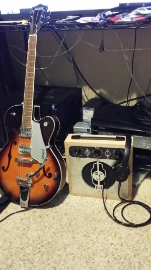

Latest addition from the BHead product line.  Just finished the Tode, resistance were spot on and voltages are around spec.  Tried my Gretsch but got no sound.  Just hum/noise when I touched the pots or balance knobs.  Think I have a bad guitar cord, will pick one up tomorrow and give this amp a workout.
Build was pretty easy, the instructions take you by the hand and make sure you don't f'up.  I didn't care for the coax cable though.  I really didn't realize how small this amp is, it's tiny!
Alonzo
