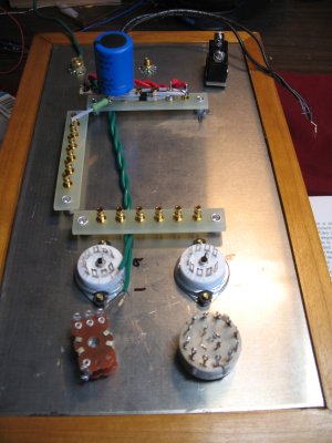

It was terrific fun forcing a dozen wires into the old  T-14, doing that with turret boards, not so much! Soooo....I'm going to take all the grounds to a single point star ground. Searching here for Star Ground is just a reminder of the T-14 issues ;D
 Question is: where's the best spot? Right in the big space defined by the three turret boards? Back by the transformer? There is no metal back panel.

Best place is as close as possible to the final filter cap negative lead.
