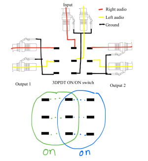

So I was looking online and would something like this picture work? Assuming I get a 3DPDT On/On switch and the input is the submissive and output 1 is the crack, output 2 is speakers, would this connection be correct?
My two worries is if I can connect both the Left and Right audio's ground together and run it like that OR Should I try to find a 4DPDT and run each ground to it's respective channels?
My other worry is do I need to add resistors if I were to make something like that? I feel like I wouldnt need to because I am just trying to make a straight connection between the input/output . . . but I'm not sure.

Offline Adrian
    • Posts: 278
Reply #5 on: April 23, 2015, 04:44:17 AM
Your welcome.
If you decide to add a switch and additional output you need to have a 4-Pole switch so the ground for each channel is switched separately - this completely separates the outputs and matches the input design. I used a 4P-3T-1D(Deck) switch.
You only need to have as many positions as outputs so a 2-throw (position) switch for two, a 3-throw for three, etc.

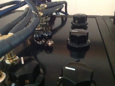

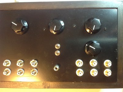

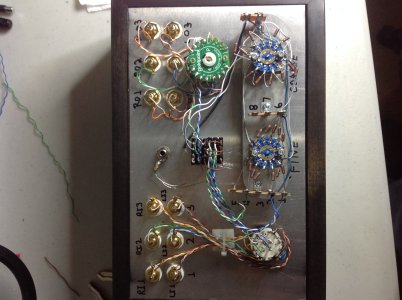

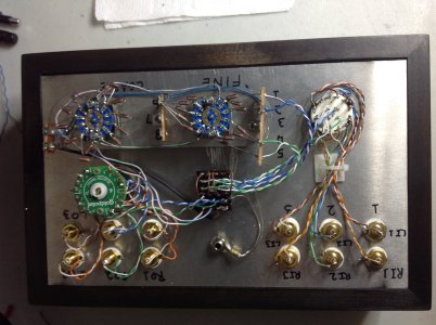

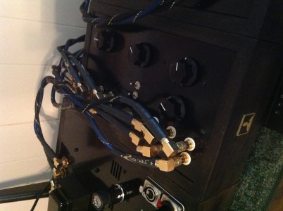

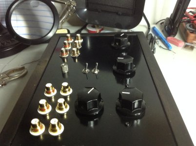

I completed my latest modification to my Submissive.
I installed switches that would allow me to completely bypass the attenuator.
I wanted a way to use the three input/output configuration and still send the source signal (cd, EROS, etc.) to a pre amp/amp that has its own volume control.
This modification completely bypasses the Submissive attenuator when I don't need it, but puts it in the circuit when I do.

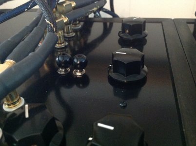

Reply #10 on: April 29, 2018, 11:04:27 AM

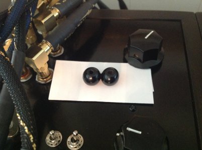

So, I made something that will gang together the two switches that enable me to bypass the attenuator.
Two 14mm wooden beads glued together fit perfectly and made the task simple and elegant.
