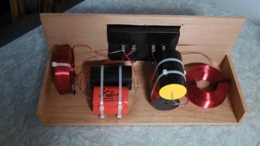

Understanding that passive components have an insertion loss (I think I saw 4dB quoted for the Submissive) does their location in the audio chain play a role?
Forgive my ignorance but I built a high-pass x-over to relieve my 4 Ohm Fostex OBs of some bass duty as I am using a powered sub that integrates well set at about 100Hz.
Driven by the SEX amp we are not talking about power to spare.
Thanks for any addition to my knowledge base!

Yes.  If you are able to place these components at line-level, you won't be scrubbing power from the speaker amplifier to get the job done.  Passive crossover components do have some insertion loss (in their pass band), but something like your second order low pass filter will have minimal insertion loss.

Thanks Paul. Well the Integration gave me +4dB in gain (along with other good things) and these X-overs may make the volume levels a wash but hopefully yield some other benefits.
